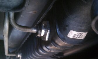

pic of cooler , what the nut screws into. if the seal comes loose antifreeze will leak in.

Do NOT remove the nut. Lint is correct it holds the cooler in the tank. If you take off the nut the antifreeze will leak out of the radiator.

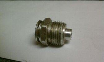

OK . if your trying to put a hose barb on the driver side,, You can you this. Fitting, 2000-up, some GM applications Fitting kits Makco Transmission Parts. but you would neat to cut the pipe then put a peace of hose on.
That's about what i'm looking for now...thanks. I tried to find a fitting to thread in the cooler but it's a phantom fitting for the most part. Not sure what other setups look like but here's mine, the large nut is what possibly holds the cooler in place, but the smaller nut is removable...nothing fell out of place.
Cheapest way is surely to attach a 3/8 hose onto the cooler line once you pull it from the quick-connect.
