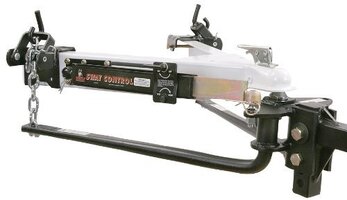

this is what i have for the sway set up. this will work with all break types
What brand and model is that? I don't know if any friction-based sway controls that work with surge brakes. If there's a new one, I'm all ears.

bigytwotone, what brand and where did you find that set up. I may look into it. I was hoping, since the sway is only at highway speeds on breezy days, that I could find just a sway bar, and not a complete setup. Maybe something like this, but that will work with surge brakes.....................
Curt Friction Style Sway Control System Curt Weight Distribution 17200
Ok so the friction sway control will not work with surge breaks but there is a sc weight distribution hitch that will work for you . If you look up sc weight distribution hitch you will find one made by Reese that's what you can use that's what they told me any how.

I bought one of these today for $40. Equal-i-zer Weight Distribution System w/ 4-Point Sway Control - 10,000 lbs GTW, 1,000 lbs TW Equal-i-zer Weight Distribution EQ90-00-1000 It is like new, and origionally was missing some small items, but the guy called about an hour later and found them. He even brought them up to the Tiki Bar we were hanging out at. No sway control on this unit, but I would venture to say just having this on there will eliminate the small amount I had before. I think I scored a pretty awesome deal. Now to see if it will fit on my trailer. I think I am going to have to relocate the jack to inside the tongue to make it work. Thats OK, it was on its last leg anyway.
Its all installed. Moved the jack all the way back and it is 39" from the ball. Instructions say 40" is optimum, but there is no place else to put it without removing the lights. Which I will do if it hits on turns or whatever. I had to relocate the spare to behind the winch post. I like it there better anyway. Sits up high and is shaded by the boat, so the dry rott from the FL sun will be slower. I was missing 2 pins that I didnt realize til I started installing it all, so I ordered them. Cost me like $8. So in a week they should be here. I will report how it handles at that time.
