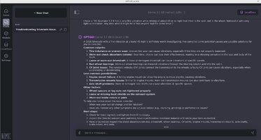

...and since we don't have access to a lot of the Late Model GM-GMC Shop Manuals...I dropped your complete Post #1 Entry into Nomic's "GPT4ALL" LLM (A Completely Off-Line and Locally Installed Large Language Model) AI... using the Llama 3,1 8 Billion Token *Instruct* Version with its Large 128KB Prompt Input Limiter and *IT* made these additional diagnostic observations and suggestions:
