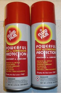

I had the exact same rust in the Saab. I think at that point, it's a losing battle. I'd just get it oil sprayed to try and extend its life.

Many Thanks to @Mooseman for introducing me to "The Fluid Film Method". I'm planning on using these two cans of the Stuff I recently got from Amazon underneath my Blue 2000 Chevrolet Silverado 1500:
