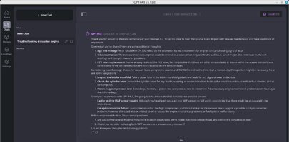

Your Latest Chat Entry added onto the Original Topic to *GPT4ALL* :
And *IT*s ...Response...(Notice the parallel similarities in its reply consistent with my empirical comments above? *IT* even stresses the oft-mentioned suggestion from @Mooseman to "Conduct a Compression Test..." )

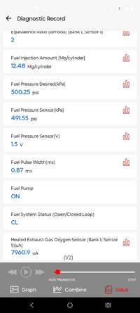

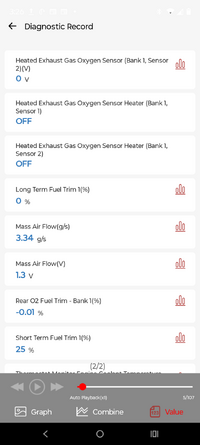

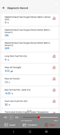

Hi again. Although a bumbling neophyte with my new OBD scanner, I tried to take some screen shots of monitored sensors. There are two sets of four, one at 5 seconds of recording and the other at 48 seconds. There is also a link to a .pdf file on the Ediag server. The lion icon is used by the browser BRAVE. I don't know if this will be useful fot you to look at. I thought that it would give you and others a larger picture of the cars running data.
