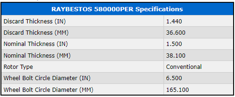

One thing I have noticed, as I spec out options, is that they're all the same nominal thickness... and all have the same discard spec thickness, which isn't that much from new. Here's a screencap of the ones for a 2500HD truck, same gen as mine (incidentally, there are two different part #s, and the ones for the 3/4 ton gasser are $20 more than for my 'heavy half-ton'. Yet they're exactly the same, except for the part #. Go figure... )

If they're in there, check the weights. They will always have the same nominal thickness however cheap CCC rotors will have a wider gap between the inner rotors surfaces where the vanes are.
