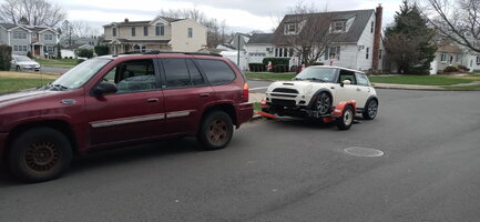

I was using the 4 wheel drive a little last week with that snow we got..i was actually gonna post here about how glad i was that i did that front diff job earlier this year...wonk wonk..and only used it to get in and out of parking spots then switched back to 2wd..did use it to tow that mini though..maybe that killed it?
