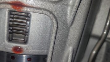

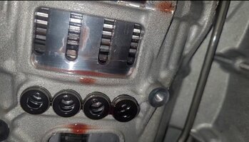

I removed the valve body from the transmission and took a photo of the clutch gaps underneath. I noticed there's enough space to fit a 3mm diameter screwdriver inside. Is this amount of gap normal for the clutch assembly?
