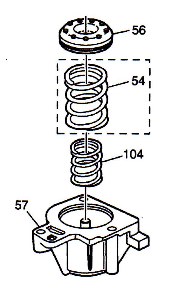

2) 1-2 accumulator, SK kit calls for replacement spring stack, Sonnax pinless calls for stock. From what I'm seeing, stock is required.
3) Similarly on 3-4 accumulator, SK kit calls for yellow spring and flipping the piston, Sonnax calls for dome up and stock spring in pocket. My truck has a small outer diameter spring in this location... With dome up with spring in pocket there wont be anything to keep this small diam spring centered... Skip it or use the Transgo yellow?
