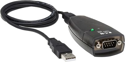

(1) Are you using the TRIPP-LITE Model USA-19HS USB to Serial Port Adapter? If not... consider getting one as it is a sound investment to solve many similar Calibration installation issues with the TIS2000 and GM OEM or "GYMKO" versions of the Tech 2 Scan Tool for SPS Read and Write Through. You can still get one HERE:
