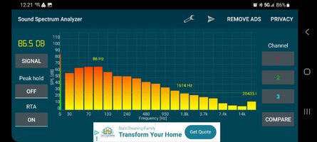

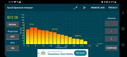

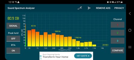

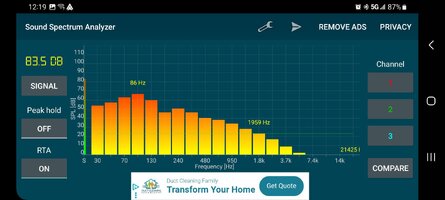

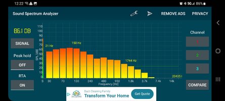

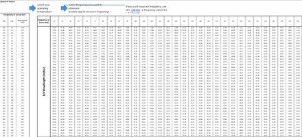

Time to address the exhaust drone. I downloaded a sound wave app on my phone that displays ambient sound at frequency and decibels in real time. I went out on the highway and took a screen shot with cruise control at 55, 60, 65, 70, and 75 mph. There was zero drone at 55 and 60. It was noticeable at 65, worse at 70, and started to taper off at 75.
55:
60:
65:
70:
75:
You can see at 65 when the drone starts to appear, the frequencies around 85Hz get louder. The plan is to build a j-pipe on the main exhaust pipe just before the muffler to cancel the frequencies around 85Hz. I used this chart to determine it's length.

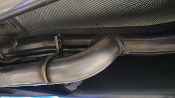

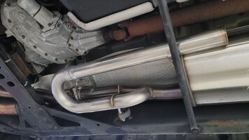

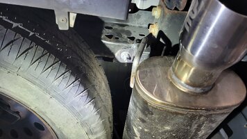

I took an IR thermometer reading of the pipe immediately after driving and it was 150F. The gas in the pipe was probably 300ish, it's my best guess based on internet searches. I decided to make the pipe 49". Here's how it looks after getting it back from the exhaust shop today.
I also had them add a hanger since the 2nd muffler came with a hook but the vehicle wasn't equipped with anywhere to use it. I think it turned out great! I did a test drive and the drone is completely gone until 70. Once at 70 it's barely noticeable, same at 75. The remaining drone is probably a lower frequency outside the range of the j-pipe but it's so minor I won't worry about it.
