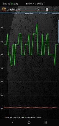

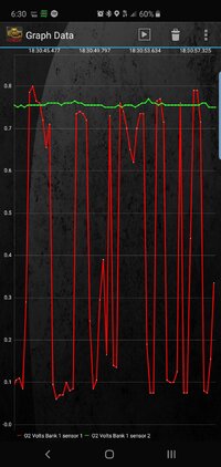

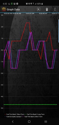

Hey everyone, after a long delay I have the screenshots of the readings Torque gives me for the 02 sensors. I also took some of my Short and Long term fuel trim's as well.
First image is
Bank 1 Sensor 1 and Bank 1 Sensor 2
Bank 2 Sensor 1 and Bank 2 Sensor 2
Fuel Trim Bank 1 Long Term + Fuel Trim Bank 1 Sensor 1
Last one I mistakenly checked everything so its grouped Fuel Trim Bank 1 Short Term, Fuel Trim Bank 2 Long Term, Fuel trim Bank 2 Sensor 1 and Fuel Trim Bank 2 Short Term.

Upstream O2 sensors (both fronts were reading .7 in my screenshots above from Torque

If you had a leak on the intake manifold gasket, you would probably see a P0171, a lean code. You could make sure those bolts are tightened to 89 inch-pounds and no more than that.
