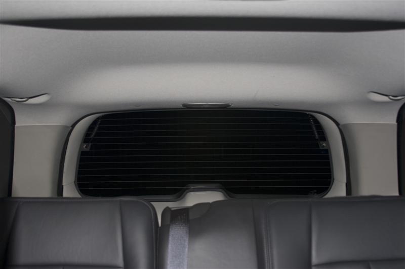

I also had a thought of putting 8" or 10" subs in the top back right/left-hand corners of the very rear of the rear windows and mounting them to the pillars. Not sure if that's even possible.
The well and spare was cut out for a battery relocation by one of the offroad guys I think. Someone else did a fuel cell for some none gasoline setup there I believe. l
I dont think the pillars would work well, but some people make stuff happen. They have cheap lil boxes to fit on sides of cargo area that do not take up much room. Tuck amp behind side panel or in the cargo well and you lose little with not much fab work.

Jackpot! I was just looking for speakers on pillars and low and behold, the very first one was on a trailblazer.
This looks to be a pretty good setup. I think I'll put mine up a little higher though and make sure the color matches better.
Big difference in that speaker and the size and weight of an 8 or 10 inch sub...
I can only imagine the vibration and rattles from hanging a sub from a lil angle bracket off some pop in clips.
I agree!
I'm going to bolt it right to the pillar behind it. I'll drill a hole into the pillar and weld the nuts or bolts to it.
It looks like I should have enough room to drill through without hitting anything behind it.
EDIT: I think I'm stuck with an 8 inch even if I move it up higher I don't think I'm going to gain 4 inches of space.
So, I'll try an 8 inch tube box and see how it looks.
Have you seen how big those tube boxes are compared to that 6.5 he mounted in the pvc? Prolly 3 times as long. Most I have used or seen would have the sub right behind the ears of the 2nd row passengers.
