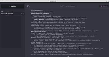

Due to the complex nature of your Question, I copy-pasted it into the Prompt Window of an "Off Line" LLM (Large Lanuguage Model) AI called "GPT4ALL" after choosing the Llama 3.1 8 Billion Token AI Model with its 128K Prompt Input limitation ...and "IT" provided this information.
Please remember that while most up-to-date LLMs have been improved in the accuracy of their *Thinking* and can often be remarkably On-Point with their replies... Double Checking against other sources of Technical Information may prove more reliable.
This is the entire information from your First Post... dropped into GPT4ALL:
...and this is "ITS" Reply:
Hope this Helps...
Here is the Link to "GPT4ALL" to allow you to Download, Install and Use this LLM "Off Line" and at your own discretion... all for FREE:

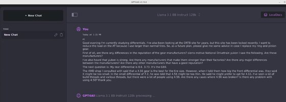

Hope this Helps...
