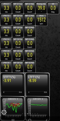

But, this should tell a story, when idling it looks like it's nearly flatlined.lol. I will replace this on Monday.
The crazy STFT is not a regular value, likely from the flatline.
budwich
Jun 16, 2013
2,027
kanata
hmmm.... quite a "dump". :smile: As usual, I find some suspicious looking numbers... beit your vehicle itself or torque... I don't know which.
I find it kind of weird that your timing advance at an "idle" is almost 20 degree. To me that is very unusual for a gas / air engine.... historically, engines would be around 6-10 advanced at idle.
The trim values are "bordering on" triggering "too rich" conditions (>25% negative). The "throttle number" (not sure which one is being displayed) also looks "different" as from my monitoring of "absolute throttle" is about 16-20% at normal "hot" idle. Intake air seems reasonable.
Not sure what to say... maybe the seating of the MAP, either the vacuum itself or the electrical connector is not good. The "flatness" of the O2's is not good... if it is true, they have either failed or you have significant leakage of gas if I understand things (leaning of trims) or a significant vacuum leak wreaking havoc on the computer trying to figure out what the engine / operator is wanting to do.

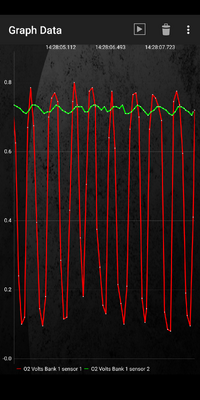

My upstream O2 sensor is pretty much dead. This is a normal upstream sensor when driving.
This is mine.

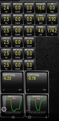

2002 Envoy 4.2.
This is my trace at idle, cat hasn't lit off yet.
This shows a small change, was a flat line at one point.
No foul odors from tailpipe, runs and idles fine, just stalls.
budwich
Jun 16, 2013
2,027
kanata
I guess I should have figured the "MF counts" for 6 cylinders... :smile: Anyway, if your replacement is acting similar to the previous one, that would be suspicious in terms meaning that the change did nothing.
This latest data dump shows 174F... how long was it run before this was taken. Maybe you have a temperature sensor issue???? causing the engine to run rich... maybe.
In its current operation, at normal idle, your upstream 02 "never" oscillates up and down like a sync wave????

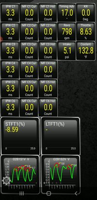

gmcman
Dec 12, 2011
4,656
Sorry @budwich , I should have posted a screenshot that was up to temp.
FWIW, my upstream waveform has pretty much always mimicked a sine wave at idle....just a slower update, and when at speed or under load, much faster response.
The Envoy drives perfect, just shuts down after a stop 1 out of maybe 4 times.
Here's a screenshot at temp at 60 MPH.
That's all over the place.
This was during the warmup, a few min into the cold start.

ok... thanks for the clare. There appears to be some "funny" with throttle position values across what you posted. These are quite different from what I see when monitoring my vehicle (2008). The small number would seem to suggest an almost closed throttle at times... maybe a potential for a stall if that occurs at the right time.

However, may be something for another thread but my upstream O2 sensor is still all over the place, but the engine runs great.
budwich
Jun 16, 2013
2,027
kanata
I think that you are going to find that the "refresh" of the data coming from the o2 sensor in torque is not quick enough to always follow the trace especially at "speed".
Reactions: TJBaker57
TJBaker57
Aug 16, 2015
2,897
Colorado
Remember now, Torque sequentially asks for each PID you have on the dashboard. It waits for each reply before asking for the next PID. The more PIDs you display on a dashboard page the longer the delay between data points on your graph.
I have a dashboard with about 16 PIDs and my testing reveals that it takes on average 2.6 seconds between data points returned for a given PID. That's a looong time. The resulting graph is understandably a crude representation of what is really happening at the sensor. My Tech 2 by comparison takes a data point for each PID every 0.19 seconds on average when reading or plotting my O2 sensors. Surprisingly, using the graphing function of Torque Pro is even faster than this when reading just the 2 PIDs of my upstream and downstream O2 sensors. Graphing my O2 sensors in Torque Pro yields a data point each 0.08 seconds.
