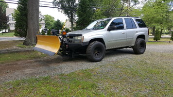

Nice! Do you do anything other than your own driveway (e.g.; commercial use) ? How has it held up? (assuming you've had it in place for awhile... )
Mektek
May 2, 2017
656
FL
There's always someone who does what the naysayers say can't/shouldn't be done. With the tiny front diff we've got it's not well suited for this application - that's pretty obvious. But it looks great!
Keep us informed how it goes...
HARDTRAILZ
49,665
We used a snowplow on a S-10 and an S-10 Blazer for over a decade with the same lil front diff and had no issues with it. We have several rental properties including a decent sized lot for the 24 unit complex and did several drives for family as well. The trans and rear diff would worry me more.
