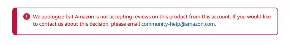

That must be the case because the second one is exactly the same. I returned it again, this time for a refund.
On top of that, after leaving a review with the photo above and advising others to inspect the part closely before use, they removed my review and are now blocking me from reviewing the product.
Here's the link to the part so others can avoid buying it.

I know I've been blocked from reviewing products I returned but having it removed? That's why I usually put my review on before starting the return. If that's what you did, then maybe because you returned it twice may have triggered something. Or maybe it is a real ACDelco but are pandemic era stock or a new supplier?
That weird washer/gasket looks kinda familiar but it's been a very long time since I've replaced one.
