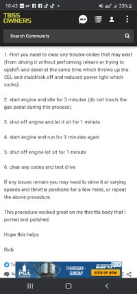

It is idling good now. I cleaned the TB again and I had the battery disconnected. After I got it cleaned and the battery hooked back up I did this, starting with number 2

That may work for V8's but it certainly doesn't for the 4.2. The battery disconnection is the only one that works for sure. Glad you got it figured out.

I do believe that's the process outlined by the OP that's in the GM SI when no tech 2 is used.
I didn't know that. I guess it was the battery disconnection is what did it. Either way I'm just glad it is fixed. Thanks for your help.
