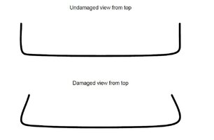

I am curious how your rear bar is in need of replacement? It is after all just a metal tube with links on either end. Unless you have seriously damaged or broken it there shouldn't be any issue. Without knowing whats going on, I would think that your end links or your bushings are the more likely culprit. Just my 2 cents.

The PO had damaged it somehow (see pic), which I didn't realize until comparing to other GMT370s.
My theory is that she got stuck in the ice storm we had here last winter and someone pulled her out by by attaching a tow strap/chain to the sway bar. It doesn't make sense but the scratch marks on the bar point in that direction.
It doesn't affect drive-ability, and there's no funny rattling or clanking sounds, but it's obviously bent. There's only 5" clearance between the bar and the ground and the bar sits about 1/2" behind the diff housing instead of in front as in the other pictures I've seen.

Well, its been a while, but I was underneath the truck last weekend doing a tranny filter and pan replacment and I got a better look at the damaged sway bar.
When the center of the bar was pulled back, the ends were pulled in along with the links. This caused the links to hit the lower control arms and bent one of them. The endlinks also have about 1/2" worn away at the bottom where they were hitting the control arms. I've already ordered all the parts and will try to install them next week. I'll do an article write up if anyone's interested.
Here's an drawing showing what happened to the bar:
