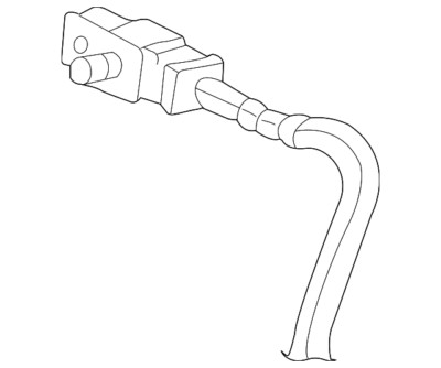

The driver's side tag light is out, and that's enough to get pulled over in NY (ask me how I know.)
The contacts in the bulb sockets are corroded. It's time for replacement.
GM Part number 1527-1206 (no longer available.)
Is there a way to replace this harness, or do I really have to make a new one with Dorman parts?
The bulbs do get hot apparently.
You can cut off the burnt holder and splice in a generic bulb holder.
Here ya go...
Perfecto! Thank you!!!! I ordered it just now.
Great deal really. Both of my bulb sockets are toast (one more so than the other) so I had to order 2 Dorman replacements.
I'll cancel that Autozone order for $68.48,,,and then you have to build the harness yourself? What a rip off.
