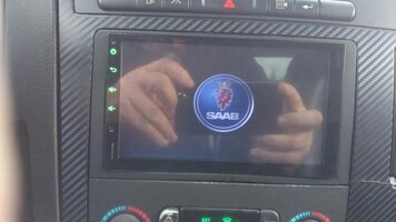

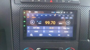

And, last weekend, I installed my Android 5.1.1 HU. It's awesome! That's all I can say. Only negative about this particular unit is the lack of an actual physical volume button. And for whatever reason, I am unable to get the steering wheel buttons to work even though I have a PAC interface. From what I can tell, the interface isn't sending proper resistances. I might try swapping it out for the one in the TB, which is exactly the same (RP4-GM11).
Anyway, changed the boot image to Saab (cool!) and the background is a nice one I found via Google Images (cooler!).
