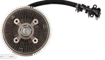

In general, SES/REP events are caused by a shared sensor reference voltage circuit. The PCM sends out a precise 5V signal that goes to two sensors on the accel pedal, two sensors on the throttle body butterfly valve, and one RPM sensor on the fan clutch. A fault in any of these three items OR the wiring harness between them and the PCM can cause an REP event. The most common cause in my experience is the last 12" or wiring harness going from the fan shroud to the fan clutch. It gets frayed and shorts out. That can be checked by visual inspection. The other items usually get shotgunned if the owner doesn't have a meter and know how to use it on the 5V reference wire.

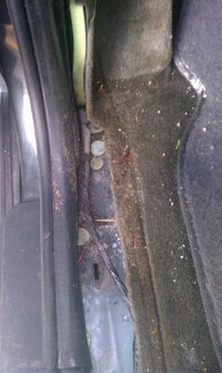

Ok, I took the floor trim off on the driver side door cuase i my carpet gets soaked when it rains and I saw this wire. Could these wires sitting in a wet environment possibly be the cuase of one if not both problems? Heres a picture of it. I have a different thread that talks about my leaks and getting my driver side carpet wet. (See Water soaking the carpet on the drivers side, do not have a sun roof. So we dont get off topic)
