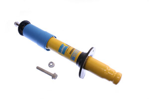

We normally call the blue and yellow item in the middle of the front strut just the front shock. Is this what you're asking about? It's a difficult and dangerous process to compress our beefy spring to add a lift spacer or change out the shock, so that's why I was recommending you only want to go in there once. Add the lift spacer and replace the shock at the same time.
I now want to do it all at once. The Blue and Yellow thing is the Bilstiend HD Strut or shock?

In that pic you are looking at a Bilstein Strut.
Some vendors call the front blue and yellow thing a strut and many more call it a shock. Please don't get hung up on the terminology. By the time you plunk down money for one, it doesn't MATTER what the vendor calls it as you get the right part for front or rear. Is this the first time buying items like this for you?

Front and rear are different items. The fronts are the coil-over damper like shown above, and the rear are just normal shock absorbers like on the rear of most RWD/4WD vehicles...

There is no OR or EITHER. A front shock will come like this.
You then need to remove (what I would call) the strut assembly as shown in the second picture of Roadie's post (#18), disassemble the strut assembly (which involves compressing the coil spring), replace the shock, reassemble and reinstall in vehicle.
