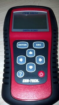

Here is my scan tool. Hope it has what it takes!

The Torque app has a fuel/air mixture display widget that shows the status of several emissions-type cycles. Not sure if it shows a specific one that is need, but I remember it showing several items.
Thank you for the help, the roadie and all. I'm guessing there isn't a code to read at this point.
Worth a try!
my cheap walmart reader has a red-yellow-green led on it, red means theres a code thrown, yellow when its been cleared but has to be driven-clear, green when you're good
REALLY!?!?!? then there is a code that should be readable. Well, hopefully accessible through my reader. Wlse, I'll be ehading to Wally's.
Thanks!
That's really cool to have the indicators.
