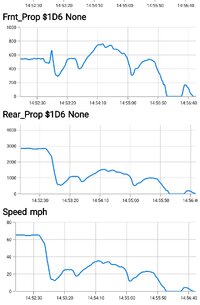

Do you happen to leave the transfer case selector in Auto all the time? If so, you may have worn the front driveshaft U-joints as they would be spinning all the time. Same for the front differential.
Actually the front driveshaft spins all the time regardless of 4WD or not.
The PID is $3162 for the front propshaft. $3163 is the rear propshaft speed.
In 2Hi the front driveshaft spins slower but still spins due to the internal frictions of the transfer case forward clutch plates.
