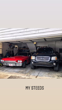

I have a 2008 Envoy that’s on a 3 inch supreme suspension lift with everything else stock as far as suspension goes. I ran across a trailblazer that had a strut header lift as well as bilstein shocks and was sitting between 5-6 inches in the front. I do not off road in this vehicle as it’s just for daily driving. I was wanting to do this same lift but was unsure of safety. The guy with the trailblazer sent me these photos and wanted to get some feed back, thanks. The envoy pictured is mine

Also, was wondering about any other way to add more lift to the back if possible, thanks
