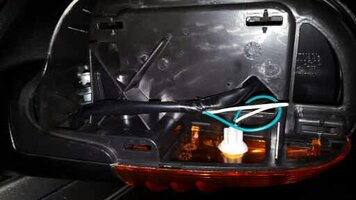

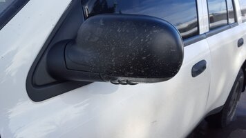

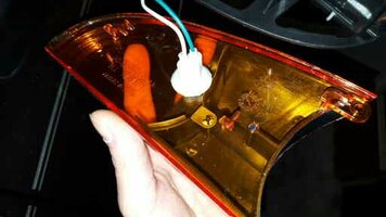

My inserts wern't plug n play with my eBay replicas. It wasn't on Chris' end rather the mirrors had a regular rubber 194 socket that the OEM mirrors don't have. I decided to strip the green and white wires on the mirrors themselves and crimp them to Chris' wires. Overall, it was a fairly easy instal with my only hicup being the wires not being plug n play.
Thanks again, Chris!!

Hi, SnowBlazer. My Mirrors are the same as yours and I'm wanting to get the LED Strips as well. Is the white wire the ground wire? And does Chris LED Stripes come with Black & Red wires?
Sweet man. I'm loving mine, maybe it's just me but I feel as if people behind me notice me better with them as opposed to not having them at all, especially at night. These inserts are brighter than your 50/50 strip you'd buy at AutoZone.
I digress...
The white wire should be the ground but I can't say for sure as I didn't peel back any of Chris' insulation to see if the wires were twisted around each other. All I could see was where the insulation met the insert. And what you see to the right of my hand are the wires from Chris' inserts that were untouched (wiring wise) by me. So the short answer to your question is yes on both accounts.

Ok, i just didn't want to wire it up backwards and short-out or blow anything in the electrical system. Thanks for the info.
Anytime, bud. :tiphat:
Before you crimp or solder, make sure the polarity is correct. You can do this easily by twisting the wires together. If you do happen to reverse the polarity, it won't do anything more than pop a fuse, worst case scenario.
Reactions: RTTBLT1
White is turn signal, green is ground.
Also, if you wire up LEDs with reversed polarity, you will not blow any fuses because the LEDs will not light up, as current can't pass through them in reverse.

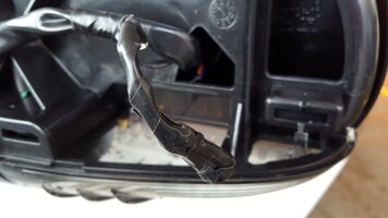

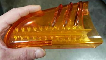

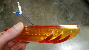

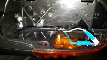

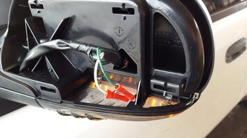

So I got the LED Inserts installed :dance:, these first 2 pics are what I started with.....
And the next 3 are the ending result, I placed quick connectors on everything.
The LED Inserts was a breeze to install, removal/install of the Mirrors Covers and the Amber Lens took the majority of the time/install. I will post pics of them in action/operating as soon as possible.
Did you modify your dust cap to fit or just scrap it?
Hello dmanns67, if you are referring to the factory Black Insert and Chrome Deflector I popped them out and keep them. TXBLAZER'S Inserts design would require approximately 2 inches of standing water in the Lens before it would come into contact with the Inserts so it wasn't a concern for me. Plus that end of the Lens is flush against the Mirror Body/Housing.

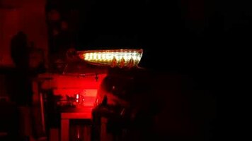

Said I would post pictures so here I am...getting these was harder than I thought it would be and there not the best but I will eventually post a Video of them in use/operating under Member Builds section
They are pretty BRIGHT compared to the factory setup. I maybe wishing I went with the Amber (Front & Rear) Color instead of the White Color. Even with the Amber Lens they are super bright and almost admit a White/Clear look when blinking but I will give it a few more miles/days to determine what I think. Thanks
