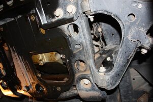

So I was doing my throttle body and when I was finished I saw some oil under my vehicle and checked the oil.
I have a massive oil lost.
I don't know where it's coming from, the oil filter looks dry from the outside.
As its almost everywhere in the front, I don't think I am leaking from the bolt on the bottom.
Where else could I leak oil from?

CaptainXL said:
The Camshaft Position Sensor might be loose. Need more closeup picks.

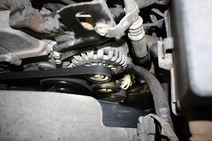

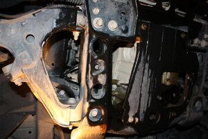

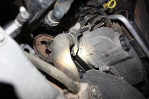

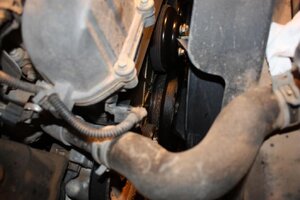

I wasn't sure from what angle, so I took pictures from every angle I could think of.
I have more pictures, but let me know where this switch is located and I will get a picture of it.
I am on a lift so this makes it easy to look under the car.
But it would be great if I can at least temporary fix it tonight.

LBB your pictures show you have had oil leaking in the past.... but what about the oil dipstick? Is it showing full or low? The pictures that show the bottom of the motor/skidplate look like my TB when I don't take care changing my oil.
The CPAS is pretty close in area to the first picture you had posted real close to and behind the power steering pump.

He's actually taken pictures of everywhere around the leak except where the leak originates. As the vehicle is moving down the road the wind blows the oil back from the front most point of the leak. If you get up under the truck and look at the bottom of the engine near the harmonic balancer/damper you will see where the oil is coming from. Another common way to look for oil leaks is to let the warmed up engine idle in the driveway or garage with a big piece of white cardboard underneath and let the oil drip down onto it. The leak is usually coming from straight above. But you also need to take into consideration the cross-members or frame that might redirect the oil as it falls. They also make ultraviolet dye to add to oil as well. You use a blacklight to find the leak.

I tried every possible angle I could take a picture from. I will clean it up on Monday and than check it again. Maybe I can see where it comes from.
