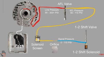

The Operational Behaviors of the 4L60E 1-2 Shift Valve & 1-2 Shift Solenoid:
