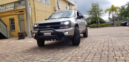

Finally got everything done and installed. Do not use the Moog 81110. Found out the hard way that they sit like the 882 springs. =[ im using stock 884 springs atm with no issue and may change them out at a later time. Ucas are also flipped with no gripe from firestone.20210214_123624.jpg

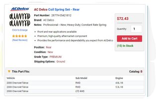

Asserv those may work from the Tahoe, I just bought OEM springs off Ebay from a government removal. I think they go to a stiffer spring to account for extra weight. It was about 65 bucks shipped.
