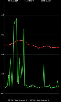

Happy to report that I've finally got my short- and long-term fuel trim issues resolved. But my upstream bank 1 sensor is still 'lazy' - here's a Torque screencap (oh, and the upward spike on the left is from me raising the RPM a bit to observe voltage changes):
Metrics (after 75-100mi and a few drive cycles): (6.0L LQ4, 235K)
- STFT ranges from 0% to -7%, usually in the negative 3-ish range.
- LTFT is 0% (dunno how long that'll last, but for now, that's as good as it gets)
- No codes whatsoever (lit or pending)
- Oil control and coolant levels are solid on this engine (so no fear of sensor contamination)
(I did note a little oil surrounding the gasket / intake ports when I removed the intake again; apparently, that's from the PCV system, and gives reason to put a catch can in... which I'll do in the spring)
- Slight ignition miss I had before repairs is now gone. Engine runs beautifully, great oil pressure, etc.
Question: Would you be in a rush to replace the two primary O2 sensors, if you were planning to leave for a long (3500 mi / 3mo) trip with the truck, towing about 6000 lbs?) Trying to get out of here before the snow starts falling (although I'm waiting for my SoS to send my renewed D/L in the mail, so I can't leave 'today', anyway).
I know if I touch the sensors, I'll run into issues (because I always have 'issues', when I repair something.) Like breaking off the sensor in the threaded bung. Or not being able to remove it. Those kind of 'issues'.
Info I have is that if things are running as well as they are, it shouldn't be too much of a concern. But I know if the B1 sensor goes, my cat on that side is at risk (and I'll be far from home)
As far as how long this B1 sensor has been 'lazy'... probably since I've had the truck (about a year now)
With those fuel trims, I'd wait to change them. At worse, it will die but it'll still run and you can get it done at a shop at your destination (easy job for them). Or have it done at a shop now. Should be an hour job, tops.

Drive it till it dies, and if it does, git 'er done then. If I had the time, I would probably replace it.
Edit: Typo fix
It should be a stainless sensor seat... I never had issues getting sensors out on that era truck. But I understand the want to wait. The chances of it dying are slim anyway and the extra heat from towing will probably wake it up some anyway. I think you're fine.

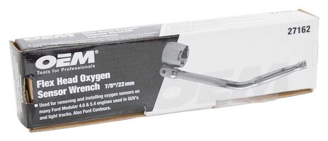

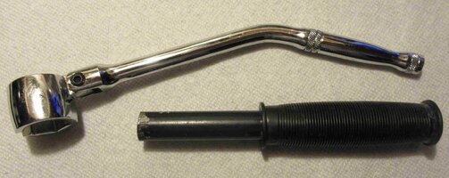

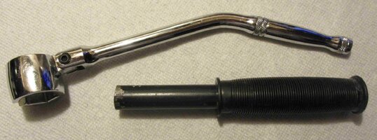

If it comes down to cases and the USO2S has to get 'Pulled like a Bad Tooth"... I'd like to suggest a Tool Combo that will compliment the ease of getting this PITA Job done... Glass Smooth. The Main Player is the "Dog Leg" Oxygen Sensor R&R Tool... along with one of the Hollow Tube Handles I cut off of a Pair of Dull Brush-Branch Nippers.
The OEM Brand O2 Sensor R&R Tool is available on Amazon for $23.00:
Between the two of these... I've been able to carefully hold the Hex Head of the O2 Tool with my Left Hand very snugly over the Hex Base of the O2 Sensor to prevent it from slipping and stripping the surfaces ... while using the Extra Mechanical advantage the Hollow, Large Caliber Rubber Handle adds after telescoping it over the R&R Tool Handle. In every case... those O2 Sensors have Yielded and unwound without a problem. Here are some images of how these two items manage to work this Magic together:
