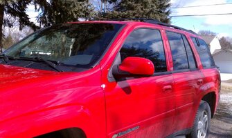

Smoothed and painted mirror covers!
Tight. And so easy. Should've done it the day it was bought.

How did you smooth them out?

Yup, I'll be adding the signals as soon as I can find a decent deal on the parts.
As far as smoothing them, very simple. Sanded them down with 180 grit paper until i got down under the bumps (didn't take much) then smoothed out with 600.
Prep with wax and grease remover, then one coat plastic primer, 3 coats red, 4 coats clear, and an overnight dry in the house.
Simple, effective, easy, and about 30 bucks total. Win!

That looks extra HOT on the red. Not too many red 'Blazers on the road. Very nice!

When I was looking for a TrailBlazer I had to have the victory red. Luckily I ended up finding a really nice one locally that was well taken care of. Shame they only made this color one year.

Quit reminding me... Did your mirrors get sanded down smooth first, or was it just a good sand job on the paint?

Eh... idk man. It looks real good on your color, but I think it'd be too much on the red.
