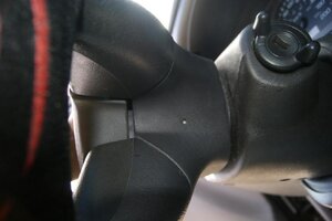

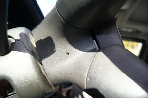

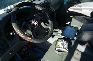

#1. you have to remove the air bag so make sure the battery is not connected!!!! take the punch and find the hole in the side of the steering wheel
and press it in there and that side of the air bag will pop out a bit then go to the other side and do the same. and your air bag is now able to be pulled out to see he back of it.

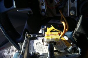

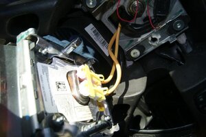

#2. you will see two yellow clip like things you can lightly pry thow's out
#3. with the needle nose pliers lightly squeeze the white clips and pull them off the air bag and there you go your air bag is removed

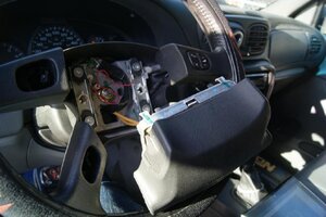

#4. to put you bottom controls back in you will need the pic again. hook it in between the wires near the connector to push it up and plug in to the controller( this part might take a couple tries it did for me)
#5. reinstall the airbag in the backwards order and there you go you have replaced or changed the lights in the controller's.
