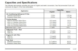

These guys are arguing me down at this oil shop saying six quarts of oil. It's a free oil change using supreme synthetic oil 15 40 I think. I know it's seven quarts. Two mechanics are arguing me down saying that's all they take. 4.2 engine. They say I really don't need seven.is this true? Out do I need to add another quart after I leave here
Its 7. I was shocked honestly myself when I did my first oil change. It should be in your owners manual.
:iagree: If you have your owners manual in the glove box, flip to the fluid capacities page, and wave it in their faces :yes:

Well since they shorted me a quart,I guess it wasn't free. I'll just assess another quart of synthetic. These guys argued me down bad saying the owner manual is wrong and that every envoy that comes through that's all they put in it. It made my laugh cause they said I was putting in too much and the auto parts store just want more money by adding an extra quart. I just thought maybe something had changed or something but evidently it didn't

Thanks for that information.I'll keep that in mind. I usually do most of my maintenance and engine work bit I was in a rush a took a friend up on his offer. He just gave me another quart.I had to show him your replies on this forum lol

Just went through this myself. Seven quarts overfills it ever so slightly, maybe 1/4 inch or a bit less on the stick.

Yea and they had another trailblazer up there today. They put six quarts in the truck. I told the owner it's seven. And he was like "what?" He looked in the manual and was surprised.Lol luckily they still had my cover. The guy who changed my oil, his nephew, said, "my uncle always taking those covers off and not putting them back on" I just face Palm.
