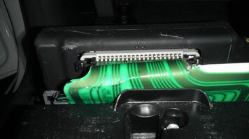

Okay so Ive been having some issues with the truck lately. Its in idle problem where the truck at idle doesn't feel right. My dash lights are flickering and my volt meter on the dash is moving form 14.5 to 14 volts. Also the tuck makes a sounds like it wants to die out at idle and only at idle. It has actually shut off twice in the past 2 weeks at a red light. I have been reading about this through the forums and checked for some solutions. I know my grounds are good so i know its not a loose connection. Next I'm going to clean out the throttle body even though I just did it this past July. And I'm not so sure this could be causing the problem but last year when I was doing a big audio install in the truck, when i was removing the rear seats somehow the seat bracket caught the ribbon on the Body Control Module and tore it a bit. I didn't really think anything of it because the truck ran like normal. But now I'm having this issue and I'm wondering if this could be the problem. Anyway I went a head and bought a used one on eBay. I actually found the same part number that's on mine right now. Now when I get it will it be just a plug in? I'm thinking I might have to get the pcm flashed to make it work right? Any help would be appreciated. Thanks guys

The BCM is not usually the problem when you are having engine troubles.
As the name implies, it operates the body electrics.
Usually, an engine problem is caused by a fuel/air/spark problem. The PCM is the computer that oversees the proper application of the fuel/air/spark.
The PCM tries to adjust/compensate for any problems with the f/a/s.
If there is an idle problem, the problem is probably under the hood.
Getting back to the BCM, it looks like you have a broken circuit, but if it has not caused any problems in the time since you broke it, it is probably a circuit that you are not using, or something that is duplicated (like a ground)

EDIT: I beleive the data strip that is torn is replaceable by itself. It should be able to be disconnected at both ends without issue. This would prevent the possibility of haveing to get your BCM reprogrammed.
I agree. The flexible circuit unit isn't part of the BCM. If you bought a new BCM, did it comes with a new flex? Odd.
Reports are that new and almost ALL used ones have to be reprogrammed at the dealer unless your option list matches exactly the donor vehicle. Evil GM design to make sure you come back once in a while and remain addicted to them.
I bought a used one on ebay with the same part number. Looks like it comes with it from the picture. Ill find out Friday when it gets here. I figured that it would have to get re-programed. Can I just switch out the ribbon on them?

Ribbons are all the same. Swap away. Be careful.
Sweet. That would mean I wouldn't have to get the bcm reprogramed right. Id just be swapping out the ribbons

I'd disconnect the battery while swapping incase any of the leads in the ribbon carry power.
