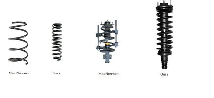

Were you referring to this compressor?
Harbor freight spring compressor
This is for a Macpherson strut, in which they probably work but we don't have those. What we have is a delicious, coil-over shock with ALOT of spring tension. GM shops had to replace their spring compressors when the Envoy, Trailblazer came out in 2002 because of this.
Be very careful when working with these springs, they will take your head off if you're not careful. I paid a shop $25 a side to swap springs and I just brought them the loose assemblies. I'm sure I could have done them but for that price I figured what the hay.
Yes those are the set, even as a back up I don't think I would even trust them after what I went through with them. When I did the lift originally I just used the rented pair for $50 which is returned back to you when you return them from advance. The rentals conform nicely to the springs and stay straight and didn't empty my 33 gallon compressor to compress the springs, which the HF did several times because they were binding up so bad.

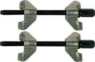

I have a similar looking set I bought from oreilly for $40 ($33 after mil discount), but they say "macpherson strut only". I didn't have any other option here in the sticks, and I reaaally don't want to do a 2 hr roundtrip drive to Sacramento to go to other stores, so does that "macpherson only" mean it wont work for me?
If your not adding a lift, they'll work just fine. It's the extra you have to compress the spring for the spacer is what was taking the toll on the HF set.

To close the loop on my question: my $40 "macpherson strut" compressor from oreilly did the trick just fine, albeit a little slower than the nice wall mount types. It always seemed in control, never was concerned about it getting to the point of exploding.
