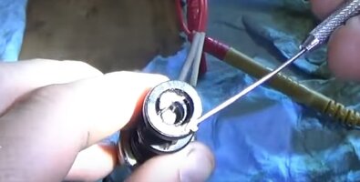

To show the Value of having THIS Type of Tool for Automotive Diagnostics... Watch from 9:20 into "Crazy Ivan's" (The Man From PHAD) Misfire Diagnostic ...Using THIS Tool...Proving that the 3.6L Engine's VVL Solenoid WAS Drawing in 0.9 AMPS ...BUT... Something inside that was Broken Off and LOOSE has JAMMED IT UP! Turns out... it was a Small Loose Piece of OEM Plastic...(looks a lot like a Broken Mako Shark's Tooth) Sometimes Blocking The Check Ball...!!!

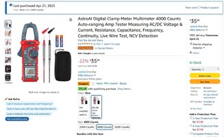

Soon after... I saw these same Items were available on Amazon at 22% OFF (4000) & 7% OFF (6000) Amp Clamps and Banged the Buy Button on BOTH of them... As Gifts for My Son:
