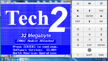

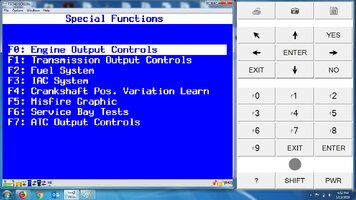

I did do some looking and it appears that aliexpress sells a setup with the MDI and the software needed for $180-$320. It is kind of unclear what all you get with each "color". This would include GDS2, Tech2Win (just like a handheld Tech2 but on your computer instead of handheld), and GlobalTis which replaced Tis2000. It appears as though you can do software updates with GlobalTis. It would appear that when you purchase this, that a hard drive comes along with it and they tell you to put it in your computer. I would probably find an external hard drive enclosure and run it off of USB or whatever your laptop has. It would be a bit more cumbersome though having two usb devices and and laptop to drag out to the car every time. I am kind of tempted to purchase this and see how it all works. Here is the link from Aliexpress

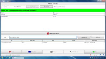

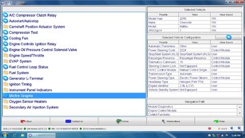

I attached some screenshots from where I was running GDS2 on a 2016 Malibu. Just a side note, check out that fuel rail pressure 600 PSI at idle. I think it gets up to around 2500 PSI while loaded. It is a direct injected gas engine.
I will post some more screenshots the next time I use Tech2Win.

Thanks for the eye opener. Looks like Tech2Win is something I'd like to get my hands on.
