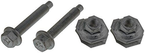

Yes... But... Realize that when performing this Hardware R&R with any of these Dorman Kit Components that... you might have to get creative ... with the effort of holding the Original, Loose Nut located IN, ON or ABOVE the Frame Rail by using a Slender or Modified Box End Wrench when Restraining and Holding that "Old Nut ". And again, later on when Tightening Up the Replacement Bolt into the "New Nut". Study the area Very Well ...and Plan Very Well for these contingencies before you begin this often Frustrating Fuel Tank Strap Hardware Replacement:
Visit THESE Links for the Fuel Tank Strap Hardware:
Now... Even though these Two Dude's Vehicles are Different GM Makes & Models than yours... View them anyway to get some additional ideas on How this Replacement HW might get Removed and manage to get the New Stuff installed in spite of the impediments:
