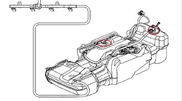

Those docs help a lot. Thanks. So there are multiple points for the vapour return to the canister. I wonder if one of the two circled valves are defective as well as the one on the pump allowing raw fuel into the canister.
Those are normally non-replaceable but someone had replaced one on his TB.
How to replace non-replaceable tank vent valve

So fairly common. I wanted to get one myself at the U-Pull so that I can inspect the rollover valve and see if I could be lucky to find one with a recent pump and get all the hoses with it. Just in my local U-Pull yard, I count compatible 3 Avalanches and 2 Escalades but oddly, no Suburbans. I was going to get one this week and possibly replace it however my recent health issues and the weather are now hampering those efforts so this will be delayed until the spring unless I'm forced to.

Just realized that I never updated this thread with the solution on this issue.
So a lot of research told me it was the overfill/rollover valve in the tank inlet. It isn't replaceable by itself. Got another used tank and replaced it earlier this spring. Confirmed that the valve was broken and fell in the tank. After replacing the tank, it's been working fine.
Here's what was happening before replacing the tank (video):
And after (video):
If you haven't started looking into this yet, you will likely need to also replace the charcoal canister because as the tank would get overfilled, this didn't allow for that air space at the top of the tank and raw fuel would get pushed into it. When I saw the fuel in the canister, that pretty much confirmed my suspicions about the broken valve in the tank.
