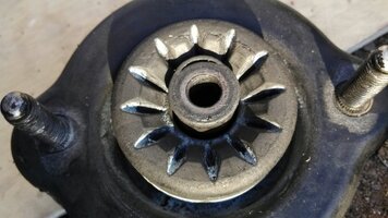

There's quite a bit of talk about broken strut mounts but I was unable to find any images so thought I would post one up. If I missed something and this is redundant, I apologize. The mount sheared off where the shock post goes up through the mount. It manifested itself with some very loud squeaking. Every time I'd inspect things trying to figure it out everything looked tight and good so I just put up with it. Finally, after putting up with it for probably a year thinking it was just normal noise caused by old bushings, I decided to pull things apart and try and figure it out. This is what I found hidden deep in the strut assembly. So nice to now drive down the road and not hear anything. :wootwoot:

Thanks for the pic. I was so pissed by the time I got around to changing mine I don't think I took any. I spent one long weekend in VA bouncing around offroad with incessant squeaking and am sure i partially lost my marbles by the end.
