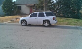

Sky High Sensor, I miss the fall when my truck was clean :no:
Leveled
Wow, that did alot to the look of it. Supposed to be nice today, I think I may play with my sensors :biggrin: If I get to it, I will take before and after shots to let you guys know how it went.

definitely see a difference in the front well = level success not raking so bad anymore
I do notice it seems I am looking more "past" the hood than "down" it now when driving it. I may still try to fine tune it today. If so again I will post pics. Thanks again guys. I knew there was a really good reason to move over from the OS.:rotfl:
