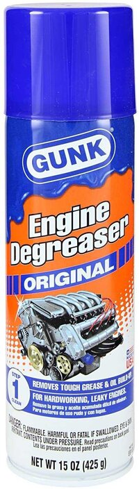

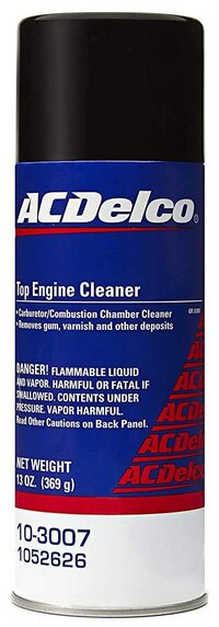

These are the BEST "Solutions" for these different problems:
For De-Carbonizing the Engine Head:
Use2-3 Spray Cans of ACDelco TEC (Top Engine Cleaner). This Foaming Chemical should be liberally sprayed all over the Engine Head after making a cardboard rectangular box along with using a large Garbage or Yard Trash Bag for a "Bath Tub" Liner. THIS Stuff will completely dissolve all Gas Gum and Carbon Build Up in 2-4 Hours. Do NOT perform this task inside of your home or garage as the fumes are extremely Toxic.
For the De-Greasing and Cleaning The Intake Manifold:
Same Trick with Plastic Lined Cardboard Box... but use GUNK Engine Cleaner first ...
LOOK at the Low Price Amazon has on the Smaller Cans of this stuff!
GUNKENGINEDEGREASER.jpgGUNKENGINEDEGREASER.jpgGUNKENGINEDEGREASER.jpgGUNKENGINEDEGREASER.jpgGUNKENGINEDEGREASER.jpg
...and later if necessary... you can completely submerge the IM under a 1/2 Gallon of re-useable Purple Power De-Greaser and Hot TAP Water. Either Home Depot and Lowes online sell Deep Black Plastic Containers for Mixing Concrete that will serve to hold large items like the Intake Manifold while under submersion as well:
That should do it... :>)

I think I have some purple power in a cabinet somewhere and thanks to multiple moves in the past 8 years I have containers to spare. I'll mix up the purple power and soak the intake and valve cover.
Question on the Top Engine Cleaner - I've seen various statements on the use of this stuff including yours. If any of that cleaner gets into the intake ports on the head, wouldn't that risk getting said cleaner and "gunk" into the combustion chamber? Would this create the potential for damaging the rings, or bending valves trying to compress liquids in the chamber?

I prefer to use Easy-Off Oven Cleaner to de-grease an engine. Works wonderfully.

Please DO NOT USE Oven Cleaners containing Sodium Hydroxide on ANYTHING Made of Aluminum (Which this Engine and Engine Head are Primarily Cast from):
Moving on... Technically... According to GM TSB on their method for using this Amazing ACDelco TEC Stuff... Getting it INSIDE of all of the Cylinders in quantity is PRECISELY the idea behind its Use.
That TSB gives a long explanation about "How to Mix the Pure Liquid TEC (NON-FOAMING Flavor) with High Octane Gasoline...." and then... after disabling the Fuel Pump via removing the PDC Fuel Pump Relay, they hang the Pneumatic Cylinder filled up with Fuel-TEC Mixture from the raised hood and after connecting up the Pressure Line to the Fuel Rail, they Start the Engine and allow it to run on this "Chem-Gas Syrup".
Once the Motor Starts, they let this mixture Burn and Clean Out the Carbon Build Up inside the Combustion Chamber and from around the Four FUBAR'd Up Valve Seats in the Six Upper Combustion Chamber..." ...and so on and so forth.
So this Powerful"Purple Jesus" Stuff is meant to Bust Up any Horrendous Carbon Deposits and side-step any need to Remove the Engine Head on GM Atlas LL8s that are NOT presenting with the same symptoms your Motor presently evinces.
It WILL be necessary to Change your Engine Oil AND the Oil Filter afterwards... and you should perform this next procedure by FIRST by Draining the Oil presently inside the Crankcase after the ACDelco TEC Treatment has been allowed to remain on top of each open Cylinder long enough to dissolve ALL of the Carbon Build Up and turning it into some "Black Mung Carbon Soup". That Rancid Stuff will collect and pool on the tops of all Six Pistons. Afterwards, just wipe out each Cylinder and Piston Head with Clean, Low Lint Blue Scott Shop Towels. AVOID BREATHING THESE TOXIC FUMES!!!
After the Re-Installation of the Engine Head, Re-Fill the Engine Crankcase with (6) Quarts of Cheap Organic 5W-30 Motor Oil PLUS (1) Quart of High Detergent Automatic Transmission Fluid. Install a Cheap, Temporary Oil Filter just prior to this in order to collect and clean out all of junk inside the Engine that this solvent will dissolve and dislodge after the TEC De-Carbonizes your Stuck, Gas Gummed Up Piston Rings at the same time. This Chemical WILL pass those Rings and end up contaminating your present Motor Oil in the Crank-Case.
Follow the procedure of allowing the Engine to Idle for around 10-15 Minutes and Do NOT Raise the RPM. Immediately afterwards, Shut Down the Motor and immediately Drain the Junk Oil Out and R&R the Cheap Oil Filter in exchange for either a Mobil1 or a K&N Brand Oil Filter. Then Re-Fill the crankcase with (7) Quarts of a Full Synthetic 5W-30 Motor Oil...Like Mobil1 ...FTW.

IIMS (If I May Suggest)...
(1) Get some "Scott Blue Shop Towels" as they have a very low threshold for shedding Fine Pulp Fibers into the Engine.
(2) Soak a few of them wadded up with the GUNK Foaming Spray and stuff them into the Intake Ports down the Length of the Engine Head soaking for around 30 Minutes or so.
(3) Gently wipe out the "Black Carbon Mung" and Motor Oil Build Up caused by the Oil Vapors passing through the Upper Valve Cover-> PCV Rubber Tube->Plenum->Throttle Body->Intake Manifold.
(4) Follow up with some more Dry Scott Blue Shop Towels and mind the chambers just above where the Valves are seated for anything "chunky" breaking loose and dropping down inside... as per @gmcman.
