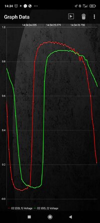

Thank you, guys. There is a lot of information here! The leak is definitely not transmission fluid. It could be the differential oil, although I checked the level recently. Also, the front differential oil seal (the external, not the inner one) and the valve cover seal were replaced by me not too long ago. So, maybe I have the combination of oil consumption and oil leak. The PCV system was clogged when I bought the truck, and I managed to clean it somehow. The truck barely passed an inspection today, because of the emissions. The CO levels are high. The cat is probably clogged - attached is the Torque-generated graph of the upstream and downstream O2 sensor. So, besides the leak, the engine is probably burning oil. Overall, the truck runs well, no misfires or error codes.
the O2 "trace" doesn't look good IF that was taken from a warm engine as the downstream should not be "waggling".
The amount of usage is "high" but it depends on the amount of miles run during that time. Compression testing might confirm a "mechanical problem" (ie. rings) and the resulting burning of oil from that direction... maybe. Color of plugs might also show something. What does your vacuum levels look like at idle and constant throttle running? It doesn't look good but at least your "oil cycle" is bringing in "fresh oil" regularly...
:smile:
Reactions: santon
The graph is definitely pointing towards a bad cat. I'm surprised the money light isn't coming on and giving a code like P0420. Might not be clogged if power is OK but it's not doing its job.
A few ways to tell if it's burning oil without smoke. Check for oily residue in the tailpipe and ask someone to observe your tailpipe while you rev the engine for some smoke. This would cause your cat to be contaminated and make it non-functional. You can also pull the spark plugs and check their condition. This would also be a good time to check compression.
Check the PCV system and the resonator box if there is a lot of oil in there. This could indicate excessive blowby that is pushing more oil into the intake.
Reactions: mrrsm and santon
Well, the engine was not hot enough when I observed the O2 sensor traces. This was my mistake. Today I checked again, and the downstream O2 sensor signal is steady.
I think the end of the tailpipe has some oil residue. I will check the resonator and the spark plugs. Thanks!
If the catalytic converter is not clogged, what could be the reason for the high CO levels? I must say that I did not drive enough before the inspection. I think it is always good to drive for half an hour at a highway speed.
