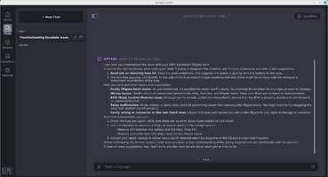

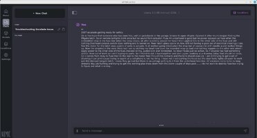

FWIW... If you have no objections to receiving suggestions from a completely Private, Off Line Artificial Intelligence...
I Copy - Pasted the entire body of your Post #1 into Nomic's Chat-Bot called *GPT4ALL* and chose the LLM (Large Language Model) called Llama 3.1 8 Billion Token AI, with its capacious 128K Prompt Entry Buffer and THIS is what *IT* Suggested:
Your Entry:
*ITs* Response and Suggestions:

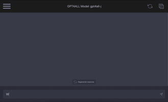

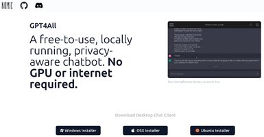

Nomic's "GPT4ALL* is a FREE to Download, "One Button Installation" AI available in Windows, MAC and Linux Operating Systems at THIS Link:
This is an example of a Q&A (Real Time Inference Speed) Interaction between a Human ...and *GPT4ALL*:
