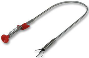

All parts stores, and especially Harbor Freight for cheaper, sell inspection cameras. For $150 or less. Here's one on Amazon for that price:
Autel (MV400-5.5) Digital Videoscope with 3.5" Screen and 5.5mm Head
So you can look inside any cylinder to check for debris.
What I would do is use compressed air and a small blowgun inside the cylinder to blow debris around and with the positive pressure in the cylinder, it should exit through the spark plug hole. You should be able to buy a compressor for well under $100 on Craigslist or the same sort of parts stores or Home Depot.
Surely your mechanics have such tools? If not, perhaps they just think you want it fixed for $50. That's not a possibility. But $2300 is insane. Prepare to buy some tools, and that's never a bad thing. Remember, he who dies with the most tools wins. :wink:
