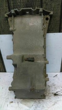

Then there is the lack of any creative space inside of the Engine Bays of the GMT360s that soon becomes the physical impediment to “shoe-horning” in any Turbo-Charger, Custom Turbo Exhaust and all of the ancillary gear necessary to pipe the Motor Oil into, out of and back down inside the Weird ‘Holland Tunnel’ Designed Crankcase. Practically everything that becomes useful in pursuit of this “Atlas In-Line Six Cylinder Unicorn” must be well thought out… and mostly… Made By Hand:
Speaking of the oil pan, I took a quick look at the design, and I believe there may be an engineered solution to oil slosh, leading to oil starvation and lunching of the rod bearings.
I found there are five sets of stands cast into the pan, presumably for attaching a pair of baffle sheets, in front of and behind the axle passage. I measured the height of the stands in relation to the level that the dipstick protrudes down into the pan and found a positive correlation. This is all speculation on my part, as I have not seen any such animal thus far in my journeys!
Here I have an assembled engine turned upside down with the pan removed. The wood blocks sitting on the block rails measure 3 5/8" which is very nearly half stick.
The pan has 5 sets of stands cast in at nearly the same height.
I thought I'd fudge it a bit, being "infinitely" smarter than the engineers, and I cut the rear baffle stands down to what would be the low level height on the oil stick. I then drilled and tapped them to 6x1.0.
Here, I cut and formed a piece of Home Depot 22 gauge metal to block the oil from sloshing rearwards, while still being lower than the low level oil height.
With the oil pan set level, my attempt at fabricating the baffle should be "submerged" when the oil level is at an indicated "full". My thinking is that is a good height for easily recharging the sump (without additional perforations in the baffle), while retaining sufficient oil for acceleration. What are your thoughts? I'm also considering adding an external accumulator to replenish oil under pressure as a safety precaution.
Rick

If it will help... Here are some images I took while photo documenting what the GM OEM Oil Pan used to look like. I think you should be able to scale these images up to the proper sizing and approach the Drill Out Locations necessary to accommodate the Oil Pick Up Tube Entry position without allowing it to make direct contact with the Front Plate. And also... for the Rear Plate comes the need to know where to Drill Out the Aerate Relief Hole(s) and the access Hole for the Dip Stick to be able to reach all the way down to the bottom of the Crank Case.
Another Consideration involves knowing where to place the Return Oil for any Drill-Out TIG Welded AN Oil Line Port for the Turbo-Charger Return Oil Line in order to reduce the chances for creating swirling eddies and turbulence that might Whip Up and Aerate the returning Hot Oil and cause an accidental drop in Oil Pressure after inducing a constant stream of air bubbles around the Oil Pick Up Tube.
BEWARE: The Gerotor Oil Pump in THIS LL8 Engine is capable of moving over 11 Gallons of Motor Oil through the Oiling Circuit ...Per Minute! So there is the need to adjust the width for the Perimeter Side Clearances on those Two Baffle Plates, inviting the rapid flow of the unpressurized oil gravity feeding from above.
The Two Plates should be measured and shaped correctly in order to allow the Oil that descends through the Side Trapezoid Block Channels as Over-Flow Oil coming down from the Engine Head ***. You'll want to get that Oil right back down into the bottom of Crankcase Oil Pan Reservoir Chamber As Fast As Possible*** in order to avoid Oil Pick-Up Tube Starvation at Higher RPM levels during "Line Start and Shift Lurching" when at speed..
43350774572_69956e70d0_c.jpg29528233298_c43d9153be_c.jpg43350774792_c2212ccaea_c.jpg29528233138_330f5826d5_c.jpg29528232918_5a6287062b_c.jpg29528232688_efb5495dc3_c.jpg43350774332_433de57a48_c.jpg
One Last Concern...
The Shape of the Channels that drop down at two points inside of the lower Oil Pan may be NECESSARY for the improvement of Laminar Oil Flow moving upwards and inside of the Oil Pick Up Tube.
If you alter either of those two locations, in the absence of having the Two Factory OEM Baffle Plates properly installed, there may be an unexpected, paradoxical lack of improvement in controlling the Oil Sloshing and inadvertently wind up diminishing or defeating the ability of the Oil Pump Pick Up Tube to function properly.
Your clever adaptation may effectively alter that expected Engineered Oil Flow Path in unpredictable ways that ultimately may not deliver the Oil Slosh Control Benefit you are seeking.

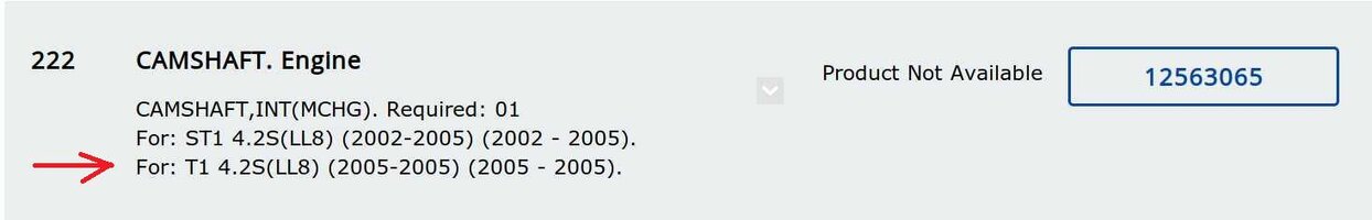

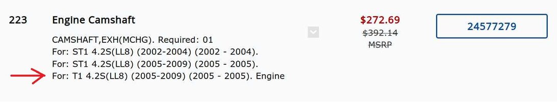

And...FWIW Rick... The 2002 GM LL8 Oil Pans might start getting as "Scarce as Hen's Teeth"... and since THIS One HAS the Dual OEM Oil Baffle Plates installed and with it being available for just under $60.00,You just might want to 'Grab It while the Grabbing is Still GOOD' over on eBay:
If you get it... Just lather up some Evapo-Rust Liquid Gel with a Paint Brush and also using a Rag attached to a Coat Hanger soaked in this Goo in order to apply it underneath the Plates. After just a few Hours of Contact Soak... Hose it Out with some Hot Water and then Spray the Plates down right away with Water-Displacing WD-40 and it will bring back those Mild Steel Baffle Plates to a Nice and Shiny, Rust-Free Condition again:

7,699
Rick... FWIW...
You could try an Experiment ... By setting the Oil Pans level on a Wheeled Cart or in the bottom of a Wheel Barrow and after filling them only as far as the recommended 7 Quarts of Cheap Organic 5W30 Motor Oil ... Roll them around while making the motions emulating Rapid Starts and Sudden Stops and observe the DIFFERENCES between the two Oil Pan Layouts are... With and Without the Oil Control Baffles.
The rolling motions don't have to be Too Drastic...
just sudden enough to create the Fluid Dynamics that happen all the time during Starts and Stops. Doing this for each Oil Pan in sequence while you observe their 'Slosh Factor Behaviors' might eliminate any guess work about which one to choose.
This might seem like it will be VERY "Messy" But I've successfully used a 1/2" X 12" x 30"+ Piece of Aluminum Plate on an inverted LL8 Engine Block for other TIME-SERT Repair Purposes. So it prompted me to think that You could probably easily duplicate this very same idea But instead, use a comparable sized Piece of Clear Plastic or Acrylic as a "Clear Cover" to Keep the Oil INSIDE of the Oil Pan while still being able to conduct your Experiments and observe everything that dynamically happens therein.
After laying the Solid Clear Plastic Template over the Flat Upper Flange of the Oil Pan, just use a Red Magic Marker to identify the required (6) Holes (2 @ the Front, 2 @ the Middle Sides and 2 @ the Back Positions) and Drill them out of the Plastic Sheet where they match up to the matching holes in the Crankcase-Oil Pan Flange. You'll also want to Drill out a Convenient Oil Fill Port through the Plastic Sheet that can be easily sealed up tight with a few strips of Duct Tape after using Brake-Kleen to wipe down the adjacent areas.
Next ... Run a Bead of light Silicone Rubber Sealant around the Oil Pan Flange Perimeter and then use the (6) Fastener Nut-Bolt-Washer Combos to Gently Hold Down the Clear Covering. This way, you can avoid Making One Helluva Mess while also getting to study just exactly HOW the Sloshing occurs in BOTH Test Cases. I think that for the amount of effort needed to make this happen, it might reveal more of what you want to know empirically than one might imagine is possible. :>)
