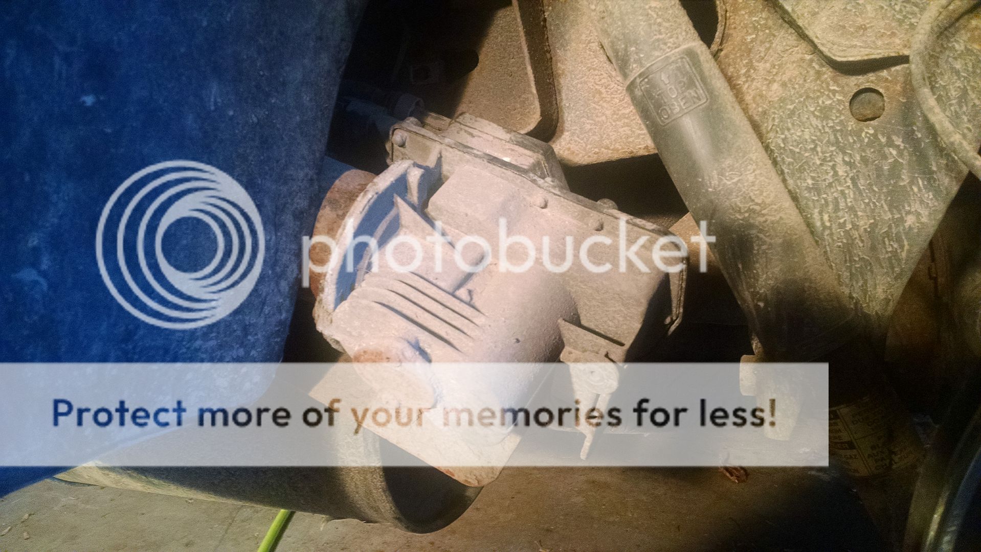

Two 13mm bolts hold the compressor to the frame rail. You need to lift up to remove it, it's got a couple of tabs that lock in to the top of the frame rail.
Remove the two hoses that connect to the left and right air bags - can't remember the wrench size but it was small. You shouldn't need to remove the other connections - you should have this by now.

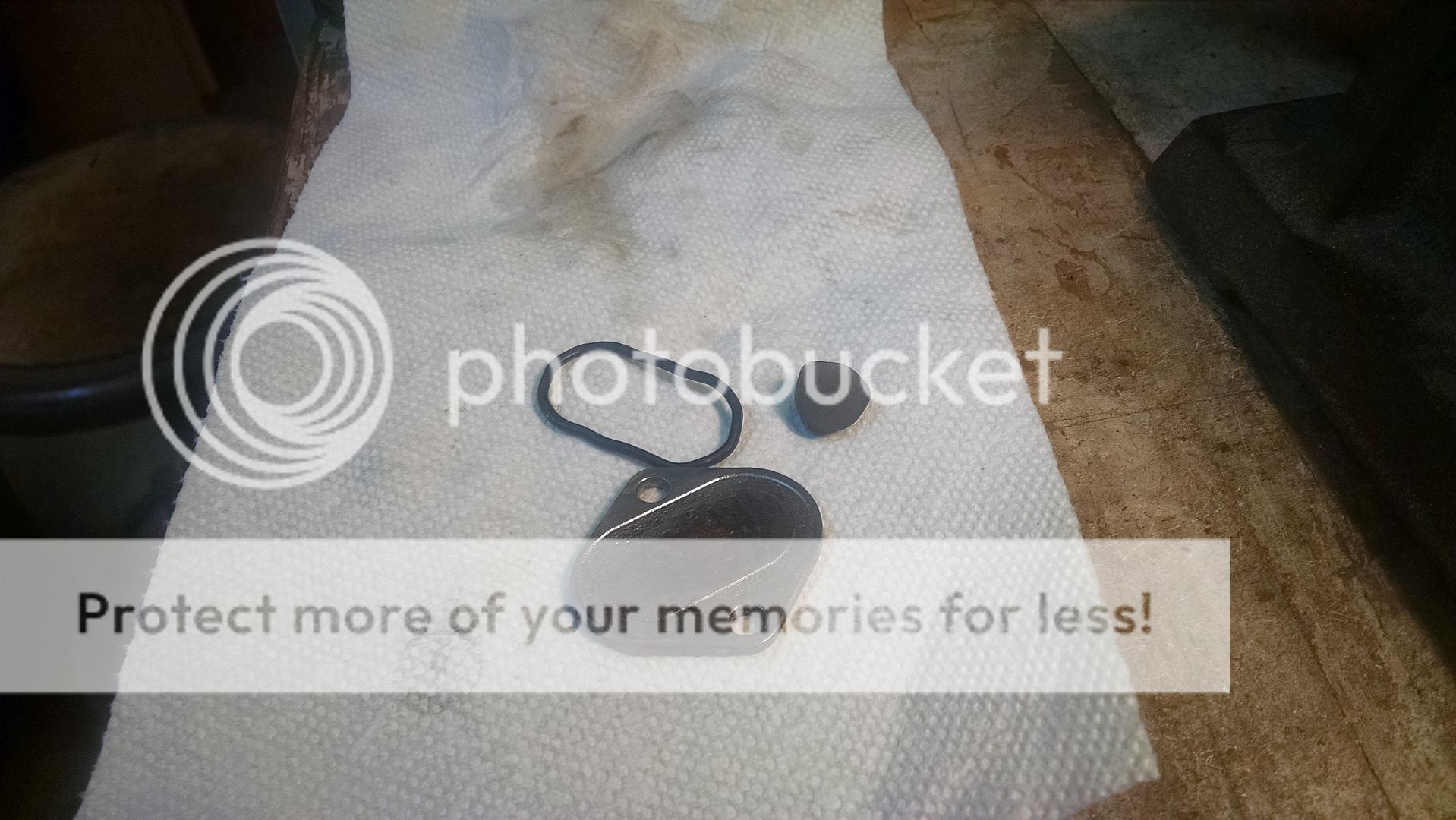

The really rusty access panel on the outside of the pump takes a Torx 25 bit to open up - 2 screws. I took brake cleaner and sprayed it down before opening it up - try to keep dirt out. You'll find these parts inside.
The imprinted circle in the rubber piece is the culprit. I used 400 grit sand paper on a flat surface to rub it back to a smooth clean surface. I also used a wire wheel on the access panel to get it clean, the inner surface in particular.
I then used silicone spray to clean everything up, the gasket as well. You can see that now the rubber piece is smooth, and the gasket has resumed a better shape.
I used a bit of silicone grease on the surface of the rubber piece and the gasket before reassembling. I also used a wire brush gently on the pump body to try and clean off at least the worst of the corrosion. I gave it a good shot with brake cleaner and then the silicone spray to clean out any dirt that may have made its way inside. Here's the before picture, no after.

In the pic of the disassembled parts, does the rubber poppet go in first with the spring going in between the poppet and the access plate? Did you treat the access plate to prevent corrosion recurring (paint/oil?)? Is your maintenance on this still holding? How many mile or km on your rig when you did this work?
Thanks!
Pretty sure the rubber piece went in first, spring against the plate. Other than the silicone, no other treatment.
