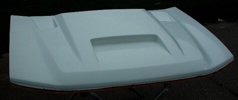

I've know for sometime now that my hood has been rusting so I'm finally ordering my new hood from Suncoast Creations.
RUST UNDER HOOD
NEW HOOD (for those of you that haven't seen it)
