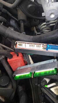

Well, i did try the relay swap, the condition did not improve. I continued searching for answers and found a tip. The 2 large wire connectors to the PCM (blue and Green) under the cover next to the battery. Removed them and inside the blue one was water and corroded female pin connectors (pin was corroded too). Cleaned the pin with emery, pulled the connector from the block of wires and did a good clean on it as well, air to blow the water out of everything, dielectric grease to seal the wires and connector. It worked... for 1 year.20201211_125349.jpg
The condition returned. I retried the relays just in case, swapped in new ones. No improvement. Went back to the PCM, disassembled as before. Water again in the connector and the PCM pin bay. Corrosion on the ground pin this time and the related female pin connector. Cleaned them both up again, sealed again and reassembled. It worked... for 2 months.

05 yukon xl same problem ,fans run ignition off ,runs down batt. after long trouble shooting, moisture in bottom of pcm . pins corroded and broken off. new pcm from flagship one 150.00 . 5 new pins solder in plug ,yes it was tuff taking plug apart ,got pins from dealer .extended fender well with vinyl stair tread from lowes, with zip ties. hoping to block water. sealed around plug with seal tape that seals to its self. 8 months later same problem. did not have to get new computer ,but had to put in 3 new pins. this time i took computer bracket out ,cut on it some ,raised it some and turned computer where plug faces up ,covered it with vinyl stair tread and zip ties. over 3 years now no problems.
Welcome to the site. Normally, I might throw some shade for posting in an old thread, but it's only about 6mos since the last update, and you may have some useful info for me (since I just converted my '03 Sierra to e-fans). So I'll cut ya a little slack, vs. being my usual anal-retentive self. :argue::popo::biggrin: (no, I'm not a mod, either... just an old fart that likes to complain... lol)
I'm not having any water intrusion issues (yet), but since you and the OP did... got any pics of what you did to mod yours with? (actually, I can visualize a bit of it, since you reoriented the PCM on its side to have the connectors / pins facing upward).
Thanks in advance, if you post them! :tiphat:
